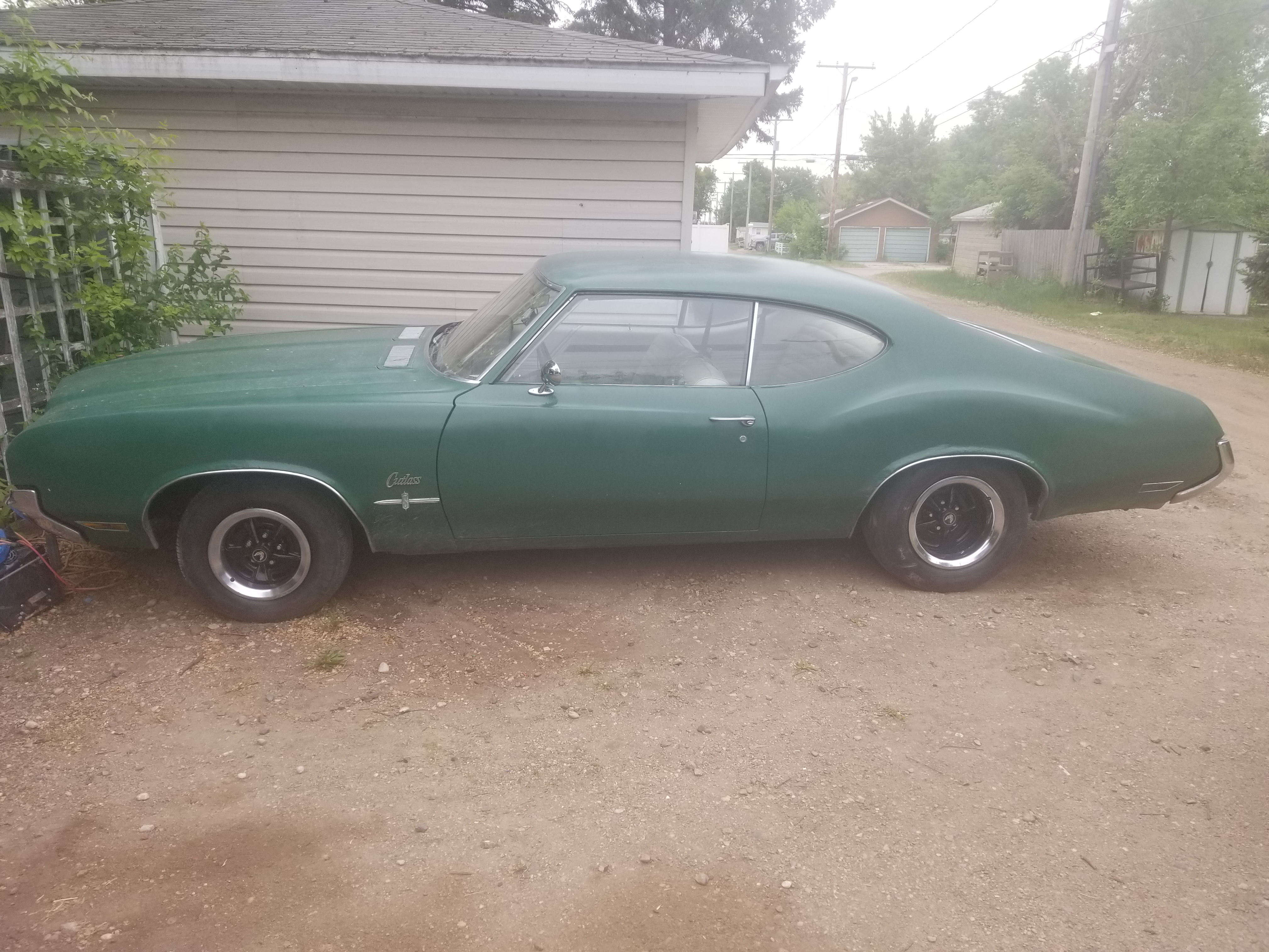

How it currently looks. 9 to 1 Olds 350 214/214 cam/TH350C/2.78 open type O rear.

Well I just couldn't stand the terrible green paint job I put on my 70S anymore. I am removing most of the paint and treating the rust with rust converter and will bondo the holes with metal reinforced filler. I have a brand new can in the basement, so it is getting used. I have multiple cans of Rust Destroyer red primer to cover it. I plan on this being a 2 year stop-gap as my Challenger and Lund boat will be paid for and give me an extra $1000 a month. So I will find a body shop to do 3, if not 4 quater panels, fix the hood, one rotten front corner and either door bottoms or whole doors. So this is why I am not super concerned on removing all the rust. The dock strike means there are very few trains coming through the CN yard right now. Short day yesterday, may not work today, so I have time.
999
Well half done. Nothing but a struggle to get this much done. First the filler didn't set up the first time. I put way more hardener than suggested. Apparently two to three times was needed. Then the nozzles on the first two cans I grabbed were plugged. After two more cans applied and next can plugged, I found a different nozzle that was wide open. I emptied the can and half as well that were plugged. One side done.
999
After many hours of flap disc, bondo, sanding and scrapping then Rust Destroyer primer, here is the finished product.
