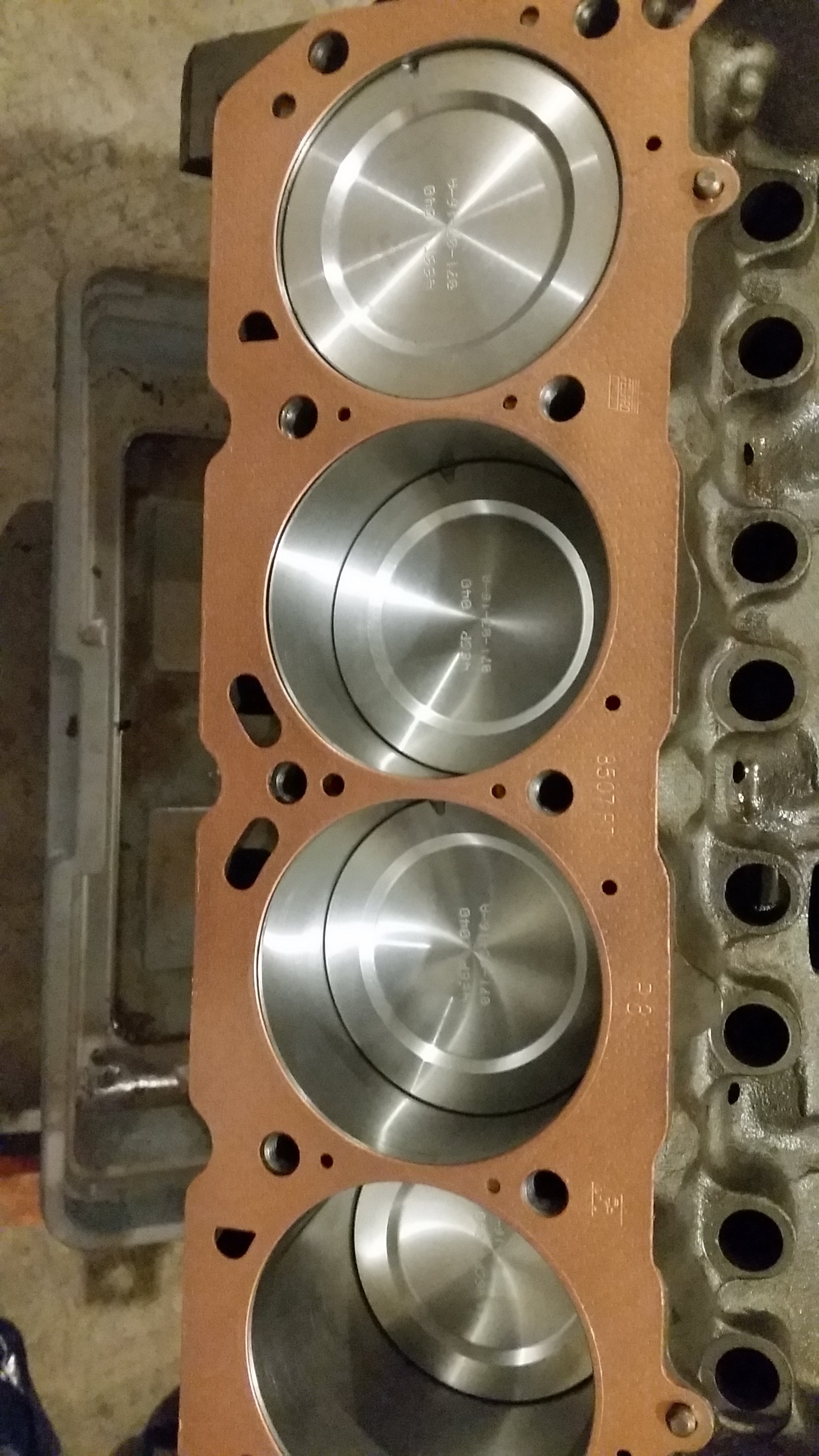

Yeah, it certainly can't hurt sealing. I may do the same on my motor. How do those Felpro head gaskets fit with the .040" overbore? I believe someone claimed they measured 4.380".Even though some say no, I still spray head gaskets with head gaskets with VHT hi-temp Copper gasket. Say what you want about 403s but one has to love the 1/2" head bolts, 130 ft.lbs. vs wimpy 7/16" 85 ft.lbs. View attachment 785
Really? I would think Copper Coat would help this from happening as well. I used Corteco gaskets last time they took multiple overheatings and still held up, using #8 heads. I did have one Corteco blow on my 76 350 using 307 5A heads without head bolt reducing bushings. It could have been movement or over torquing the knock sensor for the TBI Z71.'Im using the Cometics on mine
I was told by BTR never use the FelPro's with the 403's
They will wind up squishing into the cylinder

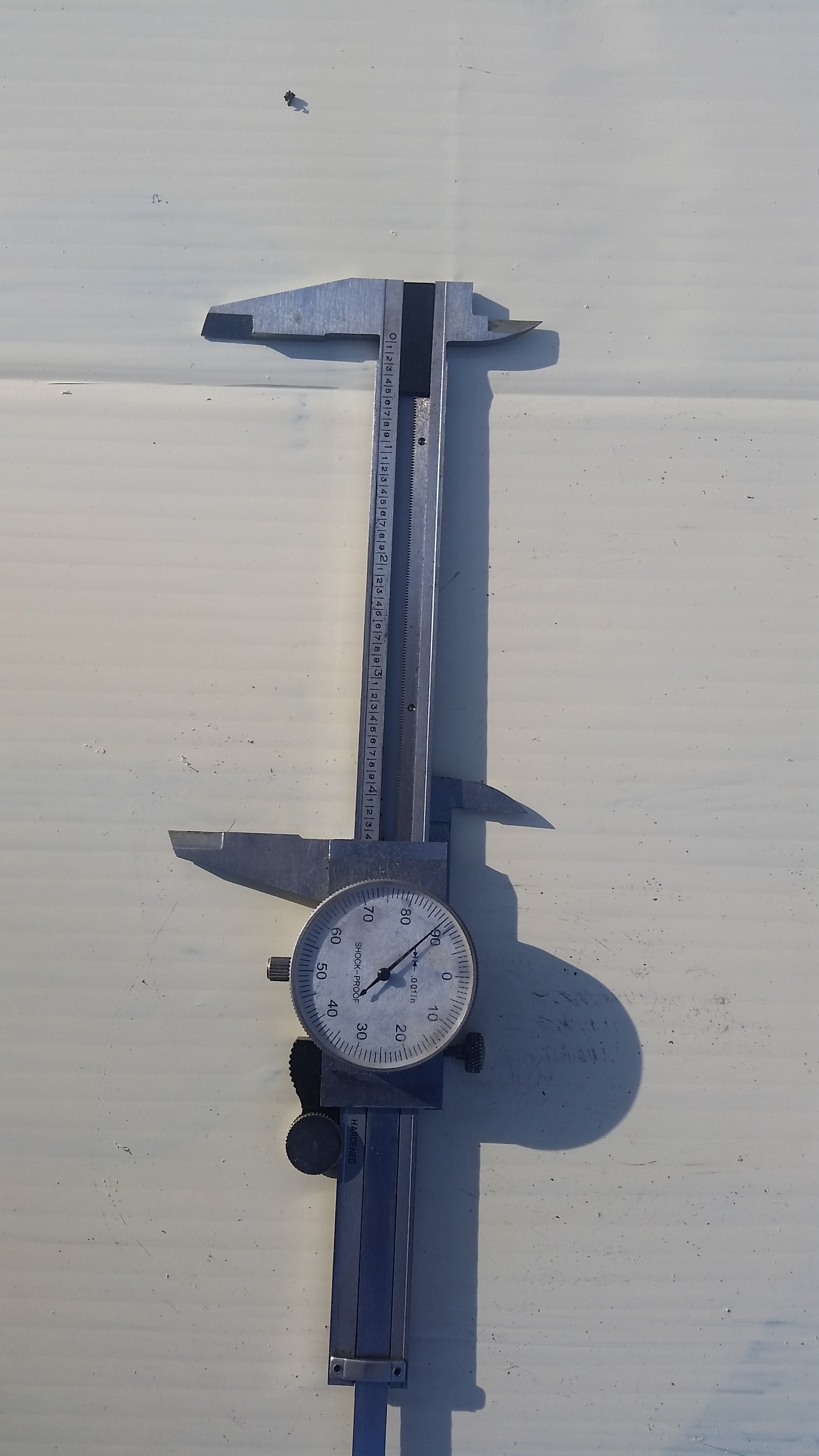

That should be close enough to the 4.390" bore my pistons need. I have one new one, I will try and take a measurement on it. It almost identical to the used Corteco's 403 bore. I won't step up to the Cometic head gaskets unless I put aluminum heads on this motor.I measured the Fel-Pro that came on it originally. My good digital caliber needs a battery, went to a backup. 4.3883"
