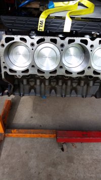

I've got to quit searching Craigslist. I spotted a "fresh" posting for a "crate" 403 engine. It was 3.4 miles from me. The story was "Father" had a G body 442. He bought the engine long block from Auto Zone. He then decide to pull the heads to put high compression pistons yada yada. He went to Summit and bought a lot of "gizmos. Then he took it to an "engine guy" to rebuild it "up." Guy had it for over a year, took it to another, same result. Got the engine back and it's sat for years. He got sick almost died but still smokes. So what I bought is short block still together.
403, 0.040 Seal pro pistons. The cam and lifters, pushrods, rockers, timing set from Auto Zone in a box. Camshaft core has #'s for smaller grind but had wrote in paint "olds 307" harmonic balancer is a solid one like 307 & 260's. I'm not sure if I like that. It came with a Edelbrock Performer Camshaft kit and Edelbrock springs, Edelbrock roller timing set, the complete Comp Cams roller tip rockers kit. A Preformer intake and a Preformer RPM intake, new HEI distributor, new flexplate, new in the box Edelbrock 600 cfm, couple of gasket sets. He even threw in the engine stand. The engine was right on the cusp of corrosion damage. I spent the afternoon cleaning, WD40'ing the engine. It rotates and is lubed. My plan is to put it together fairly stock and put it in a 1967 Olds 98.
Yah, some of the 403's had the solid balancers, not a good idea IMHO. One of the famous 403 carnage pics have that balancer. I ran the Performer cam in a low compression 403, it did fine. Plenty fun on the street but only ran a 9.7 in the 1/8. How far in the hole are those pistons? Should be fun even with high 7 to 1 compression.

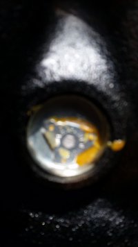

The picture that is blurry is a metal tag saying do not remove, warranty. There is another tag glued under it.
If you overheat the engine that freeze out plug tag falls off.
Not warrantied due to overheating

Okay that makes sense. This engine is years over the warranty. After purchasing the long block engine at Auto Zone, the buyer went on a shopping spree at Summit (20 miles away) and I saw dates of 2006 on a box. So I figured he purchased it around then. It cleaned up better than I thought. I'm glad nobody tore into the bottom end. I'm not sure how many "National Record Holders" Auto Zone has sold. :)•》

Just a heads up.
When you see one of those melt away plugs, its a sure sign of a shit assembly line rebuild

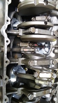

I might pull a main cap and a rod cap or two and "hi-tec" mic it with plasti-gauge, just like the 1960's. What could possibly go wrong? :)•》 that's what engine startup stands are for. I have a backup Olds 350 that I was planning on use. I already have the hard to find small block exhaust manifolds on it. The 1965 thru 1970 Olds B/C bodies have rear steering box and most had big blocks, very few had 330/350 small blocks to snag there exhaust manifolds.

Who needs BTR (Bill Travado Racing) when there's AZR, Auto Zone Racing. :)•》I pulled 3 rod caps off, crank grind looks fine, 20/20 under. The bearings look good but not sure of the maker. Rods clearance with "hi-tech" plasti-gauge was 0.0015, all 3. Pulled main #1 and #3 thrust and they were both .003. The bearings didn't have a name on them, just numbers. The one main cap bolt was dry, everything else was oiled. Engine looks pretty good. Should be a decent driver.
