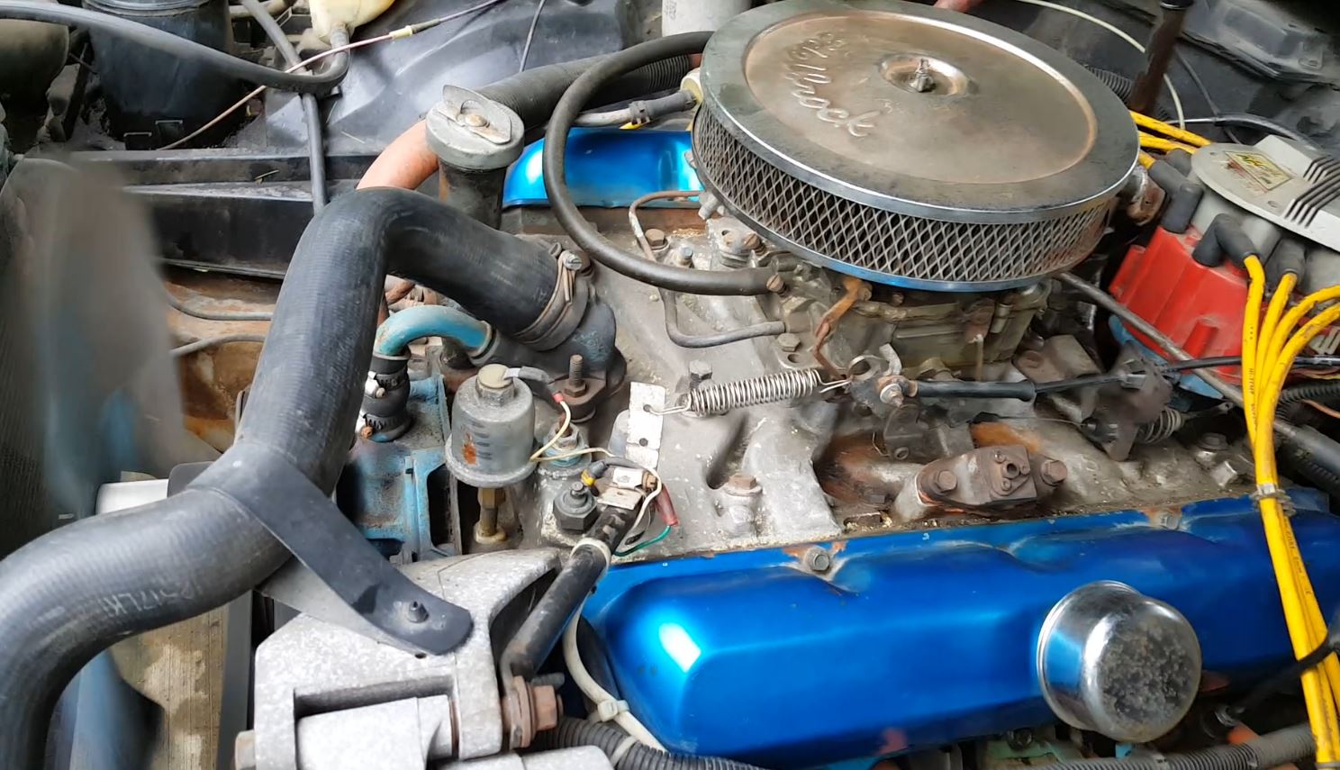

Noobie here. Was on this site for a while about 10 years ago. Then life got in the way. This car sat for 8 years. Around Sept I started going through it again. I'll thread the history somewhere here, but for now, The topic is "what I did today" .
That's an Edelbrock 1405 on a slightly modified adapter plate. It developed a vacuum leak, apparently. I did a short rebuild but I shouldn't have disturbed Mickey Mouse setup from adapter to base. I backfired today and the plate blew loose so I have to re-tap the 4 aluminum threads on the manifold. And replace that thick base plate gasket. Oh well.
I know the 4BBL on the 260 could be considered somewhat comical. In 2008 I was driving over multiple mountains to school and the Rochester just wasn't cutting it. Installed, MPG fell but at least I was no longer frustrating people behind me uphill. Worked really well back then. I had the 4BBL manifold back then but opted for the adapter rather than the offset port issue you get from the other manifold. Maybe I'll reconsider that . I dunno.
Reactions: TURNA
So you have a 4 barrel Edelbrock carb on an adapter, on the stock 260 2 barrel manifold? All 260 had factory Dualjet 2 barrel carbs, so if it is 4 barrel manifold, someone put it on.
