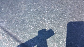

So today was the magic day. I'd spoken before about my failing Duplicolor PaintShop Pro paint. Don't get me wrong, I shot it on a another car first. But it was my daughters honda,12 years old, and ya know, 3 years after paint it was sold on to someone else. So just not sure all-in-1 mix is a good long game paint.
This is what it looks like in 17 years. At least on the trunk, middle pic roof or (hood). Third shot hood.
So the hood picture above, you can see one of the sampling areas as I tested how much dynamite I was going to require to get this abomination off my car.

Man, does that look bad. Glad I only sort of went that route, started spraying that, realized my body work was only adequate on the roof. I finished my 88 in Tremclad Primer then Tremclad Clear Coat. It actually looks like hammered Copper, or wavy body work with Primer and Clear but I choose the first one😁.
