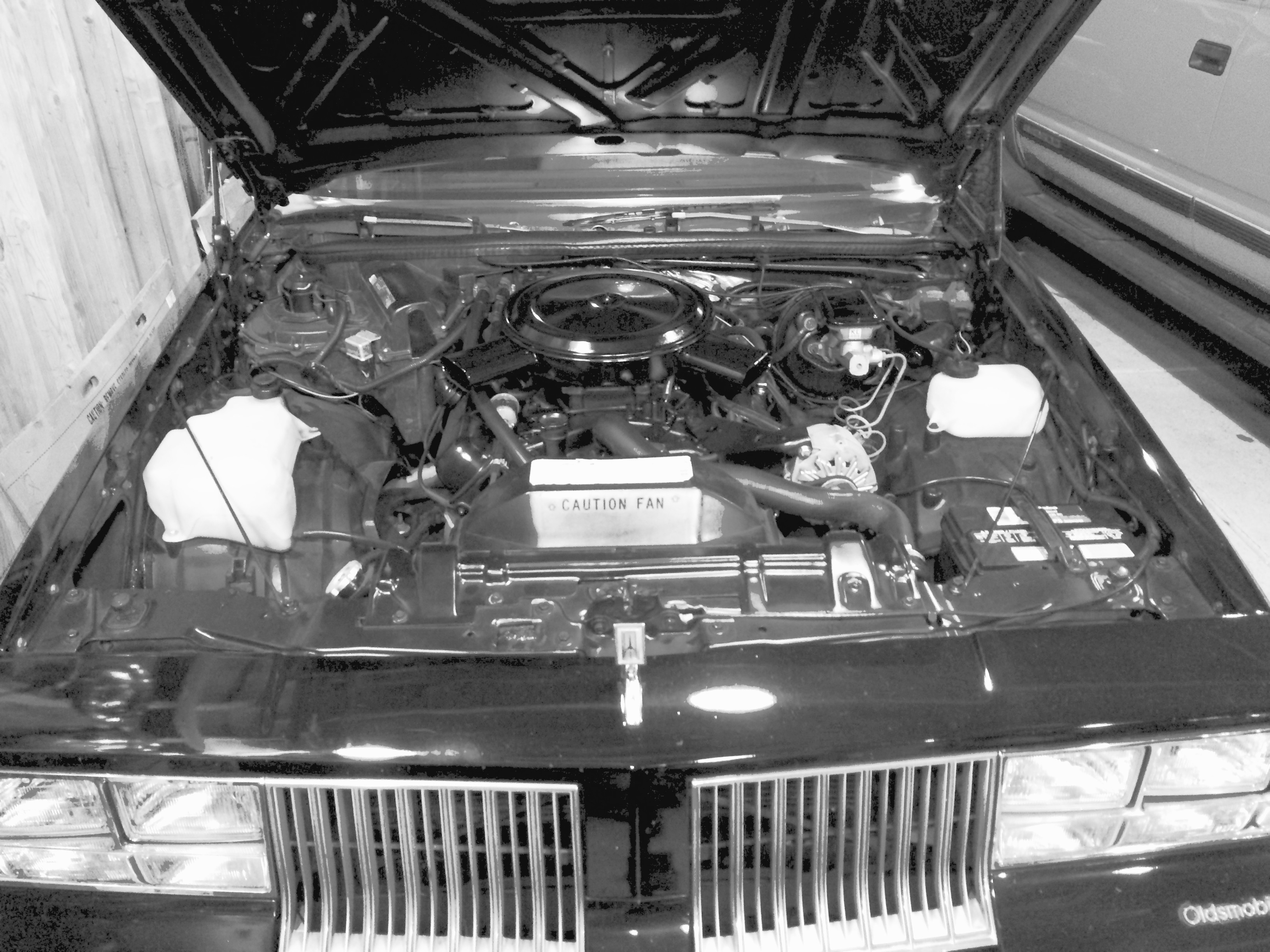

Well, I finally bolted my new air cleaner on tonight, and I'm pretty happy with the results. My goal was to get a factory-style dual-snorkel air cleaner under the factory aluminum hood with no cutting, no smashing, and no clearance or maintenance issues. For those who aren't aware, it's difficult to do this on a G-body with a 455 because the 455 is taller than a 307/350/403. I'm also running an Edelbrock Performer, which I believe pushes the air cleaner even higher. Anyway, here it is. The "Impossible". In fairness, it did take a lot of work to get this set up properly, but I think it was worth it. It actually has more clearance than the former 3" drop base cleaner did. It's a hybrid base-top combo, but it perfectly accepts the common and healthy-sized CA/SA324a filter, which is 13 x 2 13/16". And it sure looks like there's enough room under there for a couple hoses and some scoops...
Put up a list of part numbers if possible. This is a big issue with 455 in a G body. Heck even with a Performer RPM and a SB in a G body.

The air cleaner itself is a '74 Corvette dual-snorkel base with a '70s Cadillac top. When properly massaged, they fit together perfectly, and with a thin, soft seal installed, the CA/SA324A filter fits nice and snug inside. (I think any '70s GM top with similar dimensions should work about the same) I did have to make a custom air cleaner to carb gasket. This is about 1/2" thick at the rear, and about 1/8" in the front, and it still allows for very minor contact between the hood and cleaner under certain circumstances. I'm going to make another gasket, just slightly thicker in the back and thinner in the front. This should do the trick.

Ok, cool. So you're having to tilt the air cleaner somewhat for clearance? Kinda like following the angle of the hood itself?
I posted this over at GBody a while back for Olds with different GM air cleaners
Olds 442 perfect fit, obviously.......
66 Toronado distributor interference (made for points distributor) and AC muffler interference Sux I really wanted to use this one!
Late 70's early 80's Vette hits AC bracket and PCV valve
80's Camaro FITS!!!!!!! BUT you will need a PCV valve with a 90* instead of the straight up Olds version.
