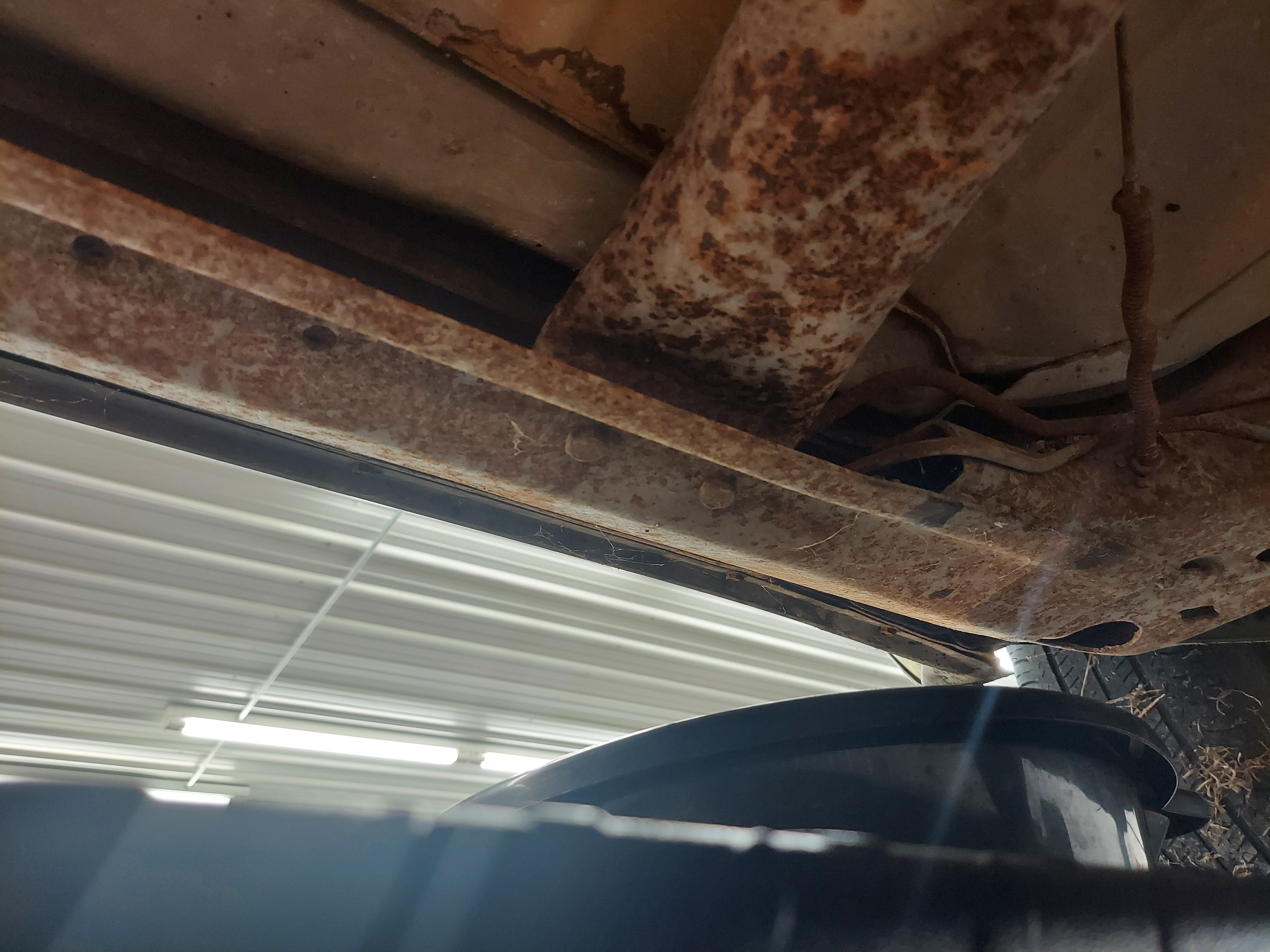

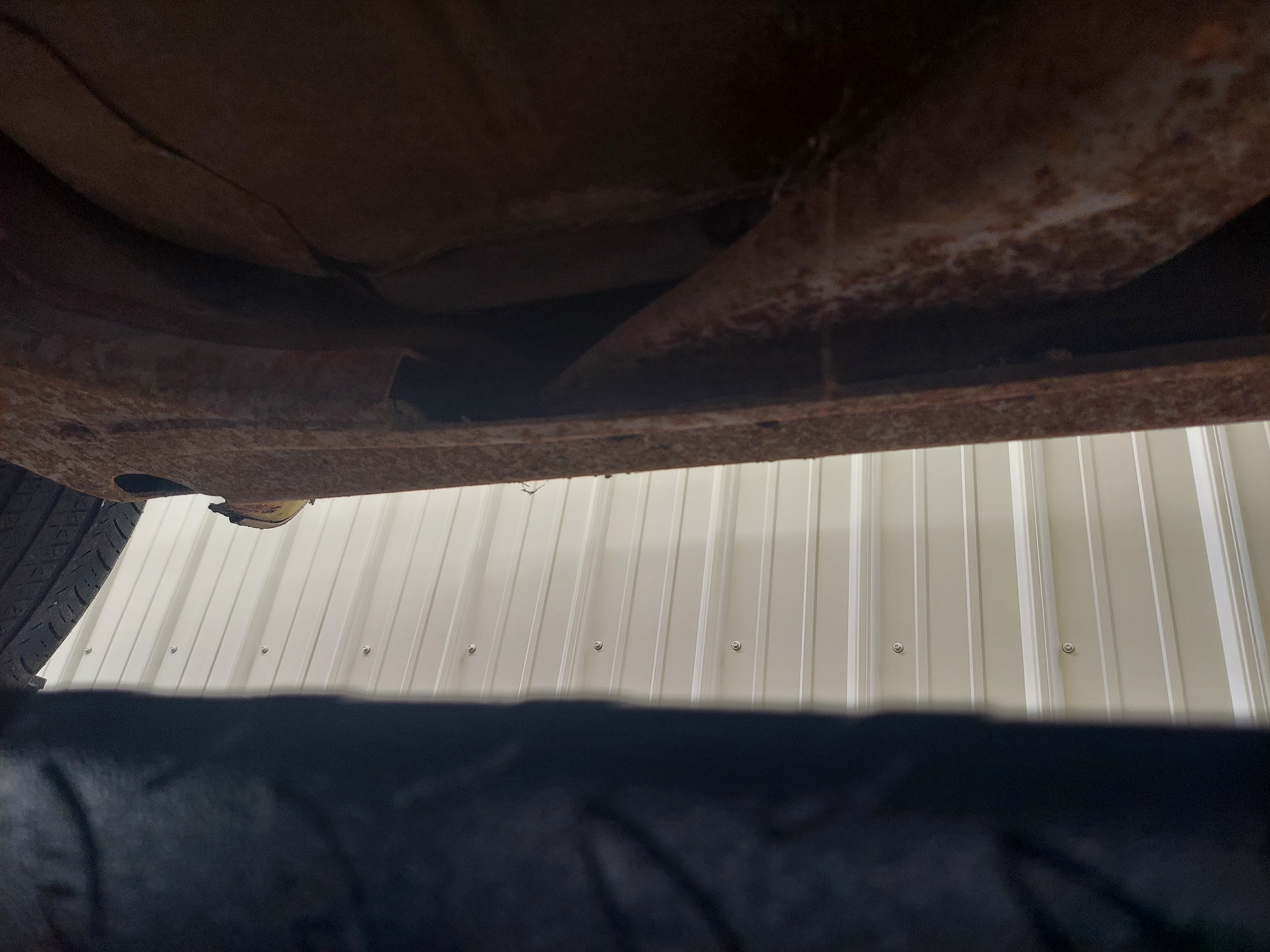

Attached are pics of the mounting at the ends of my existing 1976 cross member. Does a 73/74 cross member mount like this. Bolt hole spacing left to right is approximately 51". Left & right side pics. Note the extra set of holes to the rear to accept a longer 400 turbo.

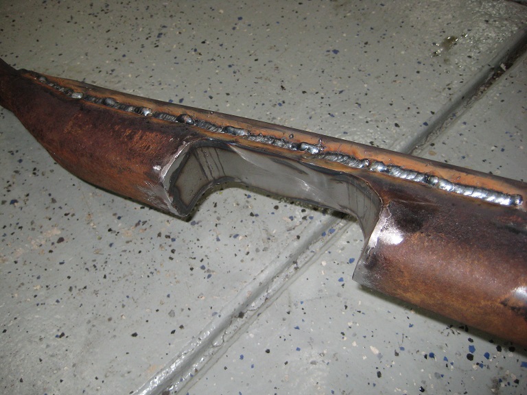

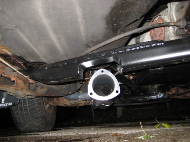

Not super clear pictures of your existing crossmember, but I put a 455 with duals in my '83 Cutlass. This body style never had true duals to my knowledge, just a single to the cat on the passenger side, and then split to duals after that. I just notched the factory crossmember, and it has worked perfectly for 14 years. If this is of interest to you, I'd be happy to provide more detail. Basically cut out a notch, made a filler piece to fill in where I had cut, and then added on a reinforcement on the top to retain full strength. I'd argue this is at least as strong as the factory piece.
