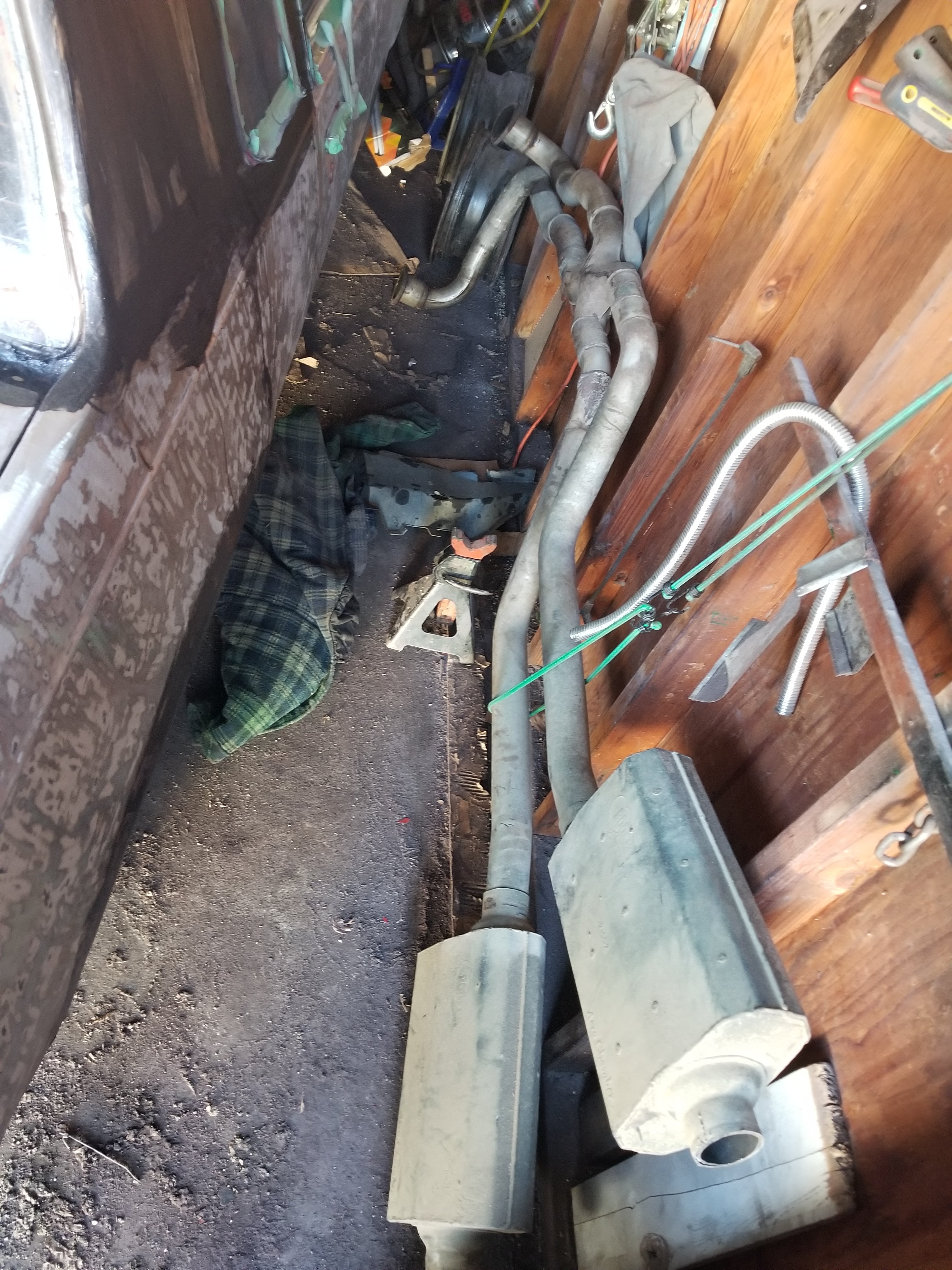

It wouldn't surprise with a good tune with headers and duals if it would hit high 14's vs low 16's. I lost no bottom end with 1 5/8" Sanderson shorties and this 2.5" X pipe exhaust didn't hurt the bottom end and big time helped the top end on the little 260. It almost felt as good as a 307:). I went back to manifolds and maybe 1 7/8" dual exhaust. In theory 2.5" exhaust should be too big and small exhaust should be better for such a small, mild V8. I found the opposite, so it is going back on. According to a few, shorty headers are near useless. Of course all full length have 1 3/4" primary tubes for Olds G bodies. The Sanderson and Thornton shorties have 1 5/8" primary and the Thornton have 2.25" collectors while the Sanderson's have 3".

Did you make that exhaust up yourself or did and exhaust shop do it for you. Looks like you can use the stock cross member.
