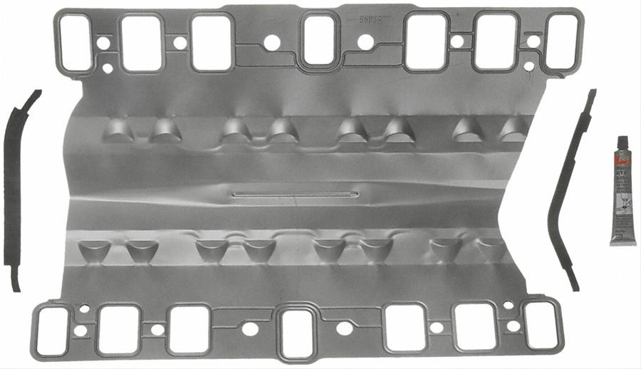

The Holley carb is generic, will work with any engine; but will need an adapter plate to work with the factory intake. The headers are Olds for sure; don't know what body/engine they're for. The distributor cap is for a stock HEI distributor, again generic. The rotor appears damaged. The distributor is a factory HEI Olds for a computer controlled vehicle (two plugs).
Edit: I just noticed in the image of the distributor, you can see what I was talking about with regard to the intake port mis-matach. Look at the size of the openings in the intake gasket compared to the ports in the heads. :eek: That gasket is for the A4 intake.

i see what you are talking about with the port mismatch, haha!

The cheap chinese Ebay distributors are fine, it must be for an Olds V8. Yeah that is a computer controlled distributor, will not give any advance at all. Those headers are the cheap Chinese stainless steel headers from Ebay, they will not fit his 86 Cutlass. They are actually BBO headers but are so affordable and well made, I plan on a set for my 70 Cutlass S. If he can't get rid of them locally, I would be interested if the price is right and willing to ship to Canada. He needs Hedman G body Olds headers for the 260 through 403 Olds V8, part number 58076.
