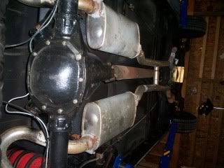

Exhaust of my Turquoise 98. That is what one week of work looks like.
Did you see my manifold? Is that the stock or should I change the ones I got? I’m not looking for horsepower just want a clean weekend cruiser.... but a posi rear end does sound goodThat's a plus but there's still the rear gears problem and the weight of the bigger "girls."
Thanks for the info you got some knowledge and experience I’m new to all this. For posi rear end 3:08 what do I need?That's the factory "S" dual exhaust, that's as good as it gets on those cars. The "rear" steering box is in the way for any kind of headers. The A-body (cutlass) is "front" steering box.
