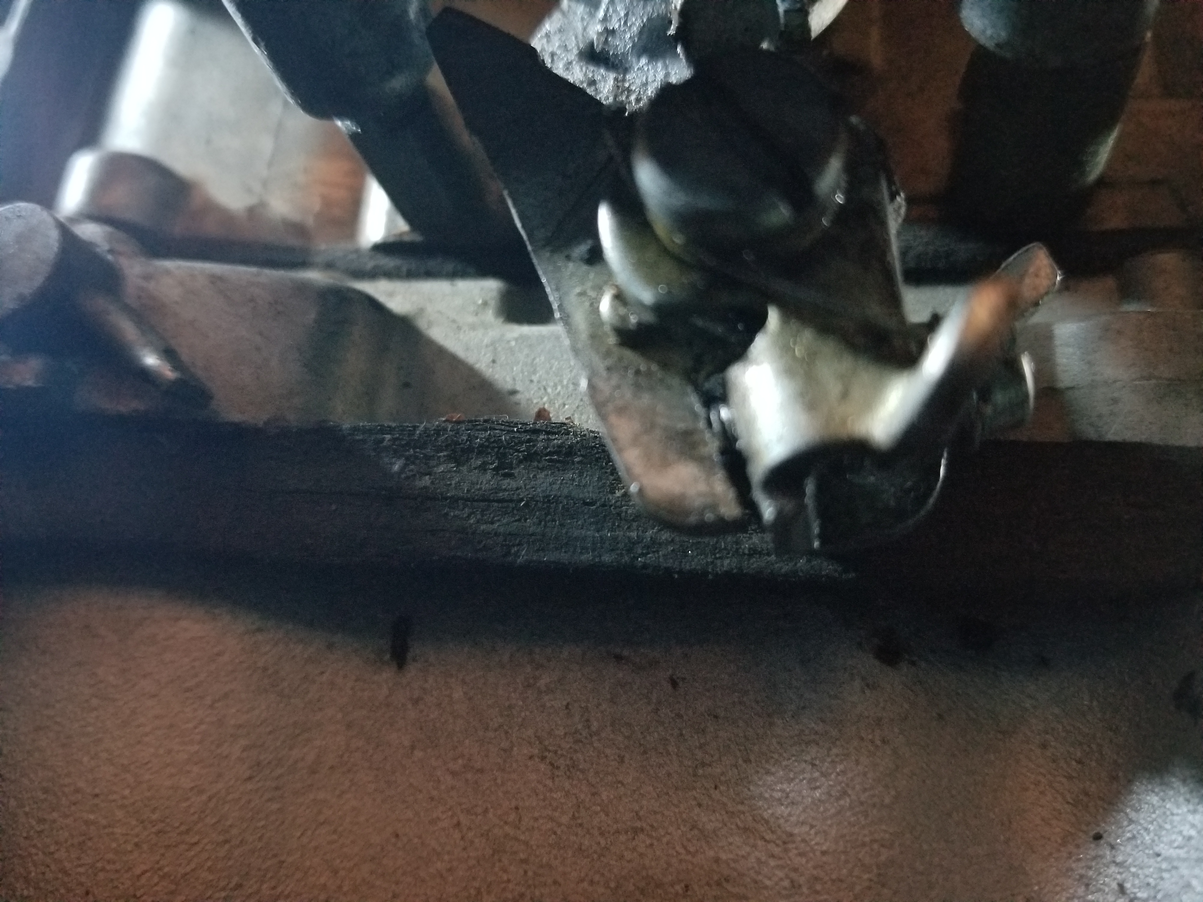

Yah the spreadbore Sniper is cool but $250 US more. Curious how reliable their electronic's will be. Here are some linkage pics.

I see things not lined up right but it's hard to see what's causing it. I would compare your carb to a similar known good one.

There is def something wrong... I see what appears to be some metal plate or something holding the fast idle in the wrong spot.

Which picture and where exactly are you talking about?

I think the fast cam is out of position.

Well after about 2 hours fucking around I put most of the original parts back except the rods and 2 links, it seems to fit together better some how. Will see how long it lasts.

is the fast idle cam on the wrong side of the linkage? What are the odds your bending the link when you go wide open throttle? Is the choke linkage hitting the air cleaner? Does the choke work correctly now? Without having a Q-Jet in front of me to brainstorm I’m just “swagging” it. I know with the choke on and you floor the throttle it’s suppose to crack open the choke flap “clear flood mode”. Does the choke close when it’s cold and you hit the throttle? The choke pull off doesn’t look right either

That older linkage just didn't line up like it should. Yes the Choke pull off was messed up, stole one off the 88 for now. For some reason it would not grab the choke pull off link, now it does. All bizarre and hopefully stays fixed. Everything is tight and functions as it should. Weird all the linkage is now tight, the fast idle cam was slightly bent now is working fine, I made sure it was properly in line.
