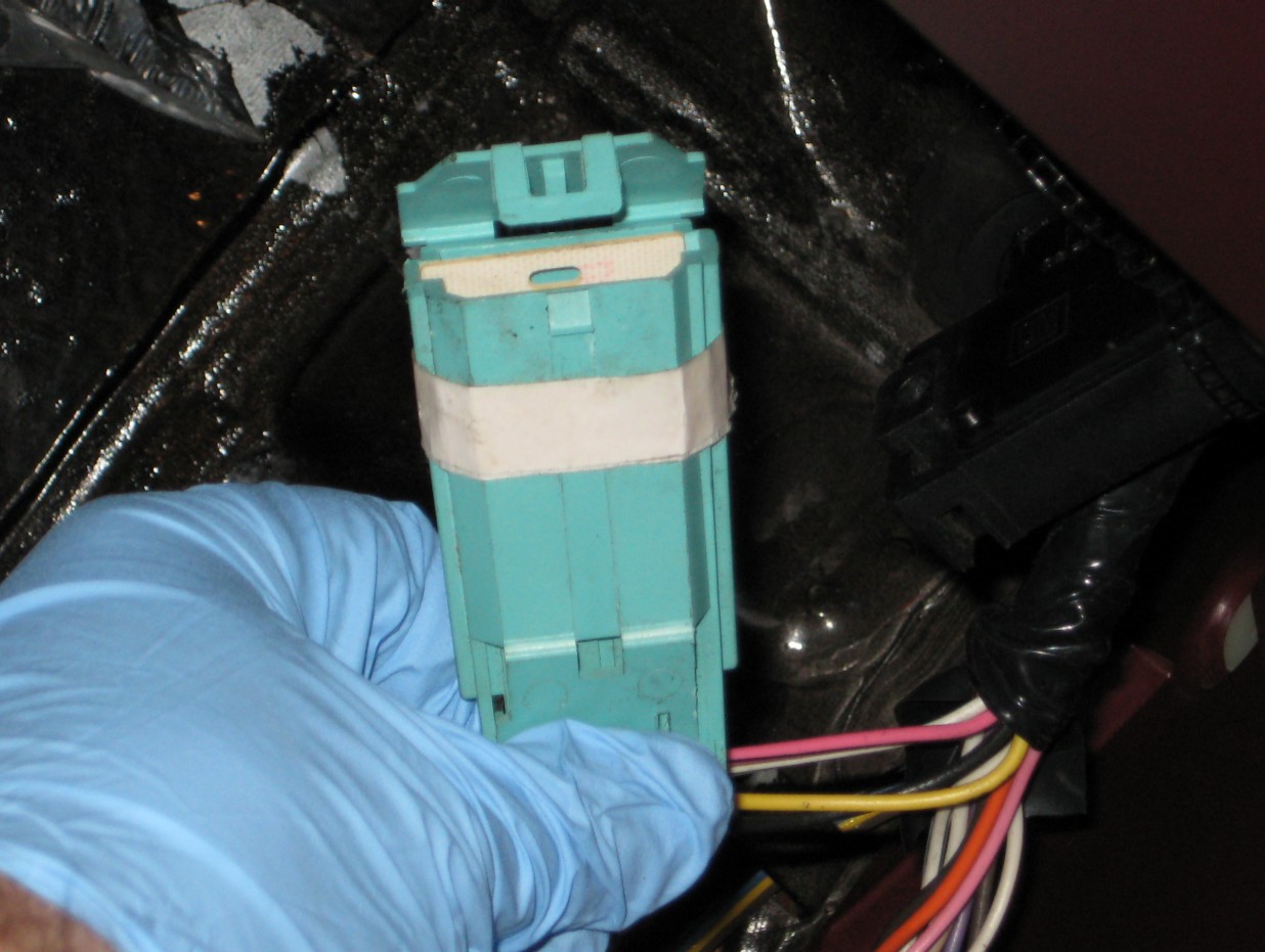

Yes, indeed. 307 produces enough power to move the car and considered to be one the most reliable engine of that era. The only thing that I hate about this car is the Computer Controlled Carb with too many vacuum lines. I know that I am getting very good MPG; however, I have been bothered recently with too many check engine lights throwing codes #21, #34, and #43.

Others will have a better answer than I will, but it's my understanding that you just need to replace the carb and the distributor. Thing is, if there's nothing wrong with them, it's a somewhat expensive and pointless effort with a 307. You won't get any more power, and your economy might go down, at least at low-RPM/idle.
One way to prevent check engine codes is to pull the circuit board out of the check engine driver module. It's a little green "can" that's hidden behind the glovebox. (See picture) You just flip open the top as shown, and remove the board that's inside. I don't know exactly what the codes you're getting mean, but they're essentially messages for things that would be happening anyway if you didn't have CCC, and by pulling the circuit board, you just won't be troubled with being alerted to them anymore.
Bear in mind, this advice is coming from someone who doesn't and wouldn't have CCC. It's probably a fine invention, but cars ran fine without it before it was invented. My car was originally CCC, but I converted it by way of putting a 455 in it. A 455 would fit in yours too... :giggle:
